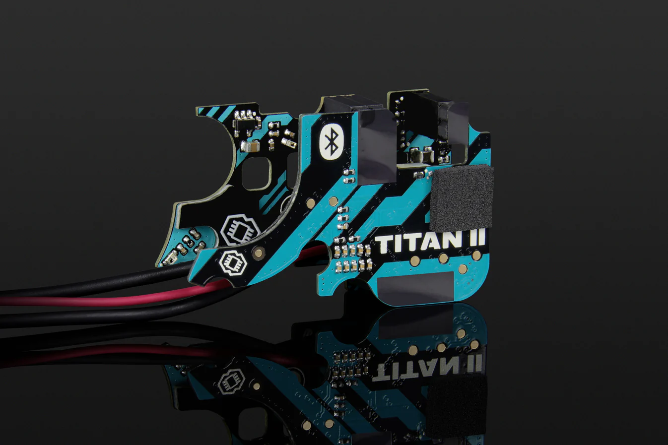

The brand new TITAN II Bluetooth® for V2 GB is the GATE flagship Electronic Trigger Unit (ETU). Built-in Bluetooth 5.2 technology gives you direct access to TITAN II Bluetooth® settings, AEG telemetry, and the ability to use your smartwatch, STATUS, and other future devices of the GATE Ecosystem. The innovative gear sensor not only counts gears, but also, as the first one in the world, determines the direction of gear rotation, offering you the most precise cycle control in AEGs. The mind-blowing optical trigger sensor allows you to set the hair trigger with ludicrous precision: even 50 sensitivity levels for the first millimeter of trigger movement, keeping TITAN V2 sensor advantages. TITAN II Bluetooth® is equipped with a multifunctional port ready for connecting additional accessories such as the bolt catch and magazine sensors, tracer in the hop-up chamber, and more.
What makes TITAN II so special?
  • Mind-blowing trigger sensor, with the advantages of the TITAN sensor but with the ability to set hair trigger with ludicrous precision: even 50 sensitivity levels for the first millimeter of trigger movement
  • Brand-new patented gear sensor detects each tooth and the direction of gear movement allowing for the world’s most precise cycle control
  • Mechanical protection of trigger sensors increase reliabilitytrigger sensors damage is now covered by warranty
  • Ultra-precise telemetry measurements thanks to the new current sensor
  • Pre-Cocking can be set in %
  • Build in boost convertertrouble-free operation in low temperatures
  • Lowest in the market current consumption. Deep sleep mode with only 0.1 mA current consumption prevents battery discharge (3x lower consumption than in current ETUs, which already had the lowest current consumption on the market)

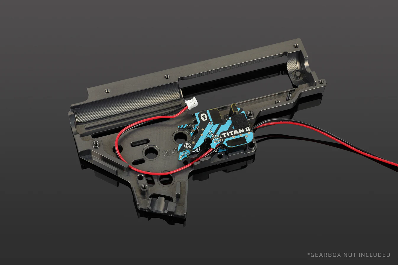

Compatibility: Most Standard Version 2 Airsoft AEG Gearboxes
Package Includes: TITAN II Drop-In Module, Installation Kit, Quickstart Guide, TITAN II Patch
