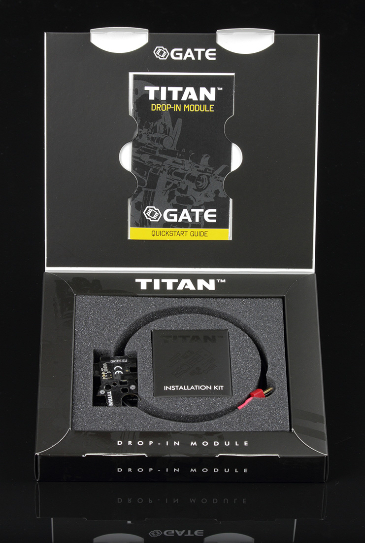

Kit contents:
TITAN Drop-in Module (rear or front wired)
Installation Kit
Quickstart Guide
Notice: To run and set up the Drop-in Module, it is necessary to have the TITAN Tactical Programming Card or USB-Link.
